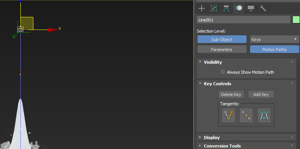

Now if you are certain that the target point is causing the focus problem you can adjust its coordinate towards-away from the camera just by using the viewport navigation controls.
The above selected function moves the target in the direction of the camera, so while checking from the top viewport move the target back and forth until it reaches the point of interest. Don't forget to do this while Auto Key is on and at the right frame. Although this action does not affect your viewpoint, it essentially changes the motion path of the camera target so the overall motion might differ, in some cases, create motion that is not what you been actually looking for. It can be adjusted anyway. Target distance might be adjusted to match  throughout the entire camera motion by looking at the motion path of the camera target.
Motion path can be turned on from  the Display Panel in the Display Properties section. (A checkbox labeled Motion Path
Although you can turn on the motion path in the Motion Panel and can edit the control vertices of the path (The keyframes) as a Sub-object of the path. Like editing a spline.

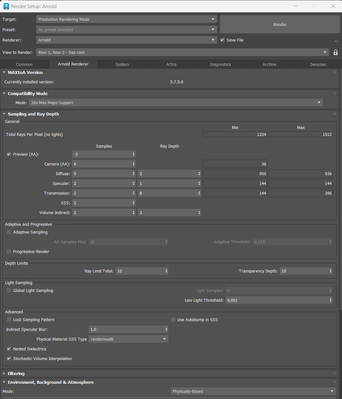

Last night i tried rendering it with the targat at the exact right points, but that did not seem to help the end result even a little bit.
So it is probably within the f-stop or the DOF, but both i have no experience with or do i know how it works :].
But i use the Arnold renderer and posted below are my camera settings and my render settings.
I hope you can find something within these settings that might help me out!
Thanks already.
- Nick
Message 4 of 9
Byteman
If we're talking about Arnold, even its sampling values can cause blur effects. When the values are -if I may use the term for it- "undersampled" the corresponding component loses detail. I'll check it out in front of the computer. You may consider sending the file so that I can check easily. The scene objects are not necessary, if for any reason you are not allowed to send, you can delete them and just place a box at the same spot.

It seems you haven't set the camera target as the focus point, instead a custom target distance set by a value. That may be reason why moving the camera target doesn't affect the focus. Below are the parameters.
Remember also that scene scale size can affect the DOF values that you use.
