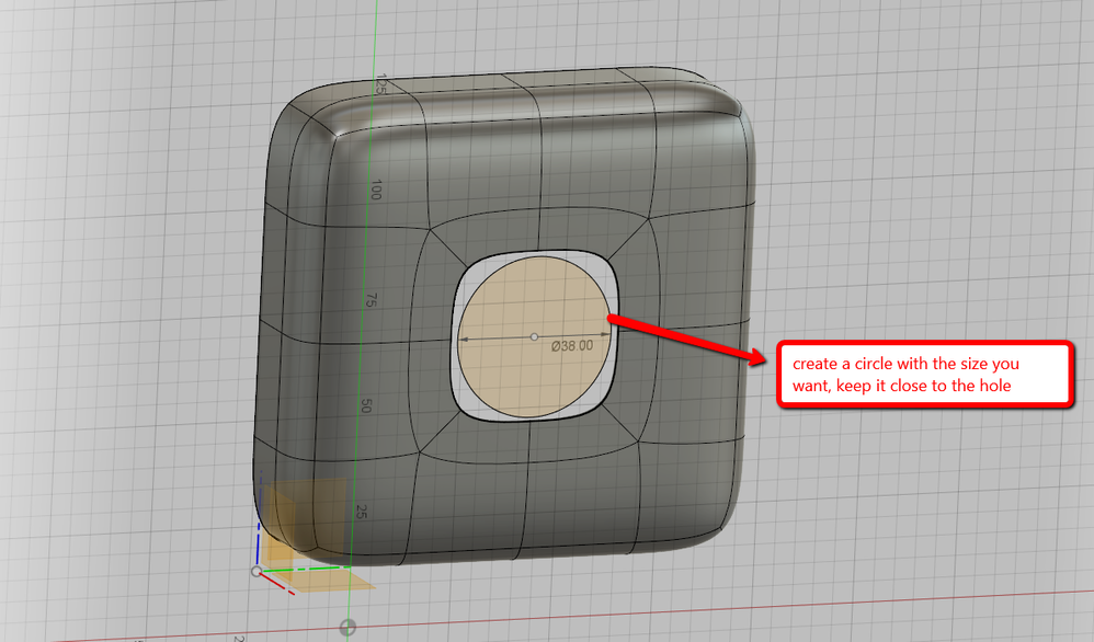

I agree with you about the importance of accuracy in product design, actually, in this case, the Match command would help a lot.
Once you get most of your jobs done, you might want to keep some circle as accurate as possible
I made a case to show you how this command works,  maybe it will help you for most cases.
if you think this is not enough, i recommend you to use parametric bodies where you need to control the size, and the blend those parametric bodies and T-spline bodies together.
