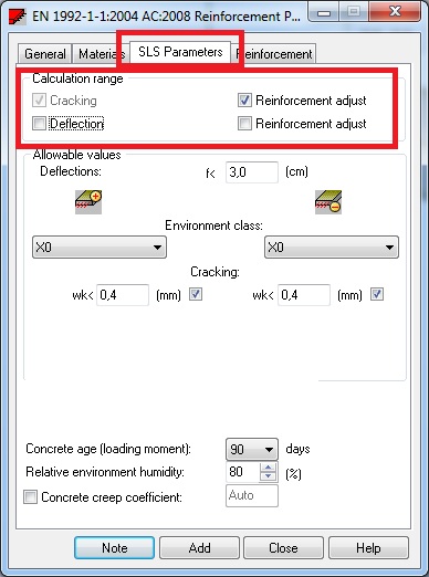

When calculating plate/shell reinforcement I sometimes get the message "Required types are not ascribed to SLS combination. Calculations may be incorrect".
Where can I find a list of the reqiured types?

Can you be more specific?
What are the types that are not ascribed?
Your pics indicates that these types are reinforcement parameters. Is this correct?
Does this warning have anything to do with the SLS load-combinations?
To be more specific myself; does this warning have anything to do with the loads or factors included in the SLS load-combinations?
Hallvard,
Please check the message 8 from this topic http://forums.autodesk.com/t5/Autodesk-Robot-Structural/sizing-slab/td-p/3280315
