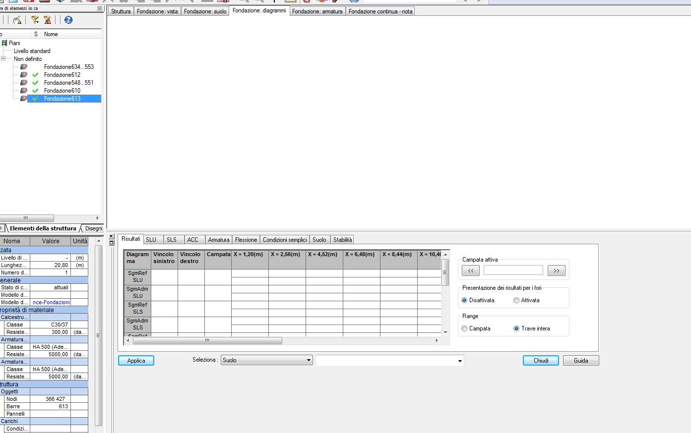

I do not understand why on some foundations do not see the pressure of the soil (see image), while on the other I see them.
The settings are the same and is the same file.
What might be?
Tanks
Andrea

The diagrams ACC SLS ULS I see them
I can not see the pressure and seattlement on the ground .
Andrea
After reimporting this element to RC module it works.

or unfreeze reinforcement and redesign element
