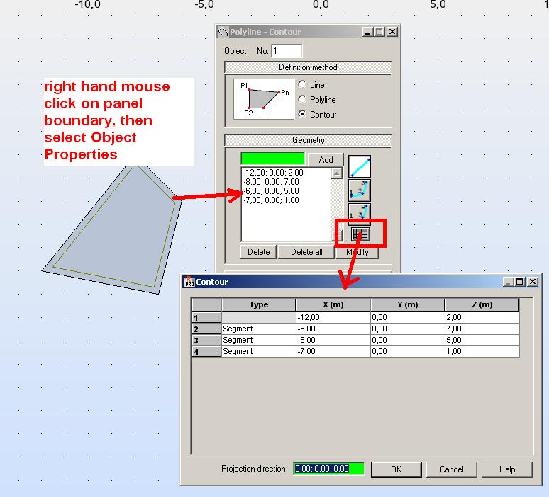

Does anyone know a way to obtain a table of all panel coordinates in a model?
It is frustrating to try and track down where mesh inconsistencies are occuring by clicking on every panel in the model and checking that the geometry is in fact correct.
Cheers,
Tony

Here you are

Rafal,
Thanks for your answer, however;
I have already been using this method to revise panel geometry.  For some reason my panel geometry was slighty out (on multiple panels) and I want to see all contour coordinates in a table.  So if I have to change the geometry on 80 panels, using your method is extremely tedious and time consuming.  If I could dump the coordinates into excel and manipulate them before re-importing them it would be better.
For example if I have complex pattern of wall geometry and the floor height is changed, I need to click on properties for every panel on that floor and manually update the height.  This is not efficient.
Additionally, I find it annoying that Robot does not round the coordinate (of the node, panel etc) to the same number of decimal places as the user setting for dimension?
ie In parameters definition I have set dimensions to metres and three decimal places (1.012m for example).  So how/why can the panel contour have a position of 1.01200025?
Thanks in advance for your reply.

@tony.ridley wrote:
....... If I could dump the coordinates into excel and manipulate them before re-importing them it would be better.
No problem, just write small VB macro in Excell  accessing robot data via its API doing such operations.
"Round up" function is registsred in our database as an enhancement and it will \ may be considered in future developement plans.
Rafal Gaweda
Take a look at attched xls with macro.One button to import geometry (characteriscic points coordinates) of selected panel(s), second - to update panel(s) geometry basing on data in Excell. NOTE: modify only cells with coordinates.

Rafal,
Genius - your macro worked a charm.
My faith in Autodesk / Robot is stronger now!
