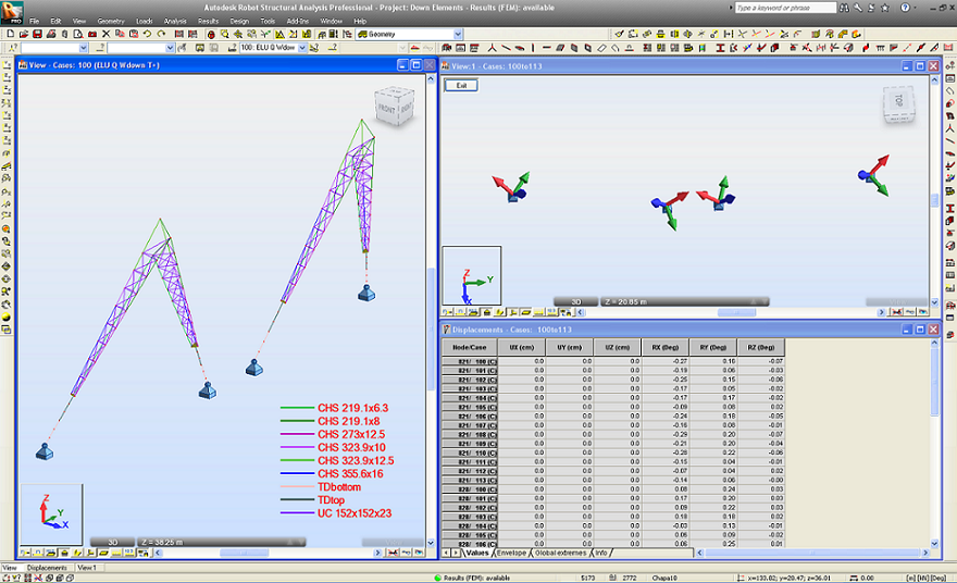

Hi!
I need to extract node rotations data from my model. The problem is that only rotations according to global coordinate system are available. In several cases, I need the local support displacements and rotations to find suitable bearing device.
As you can see in following, the node rotations from the supports don't match the coordinates from the adjacent bar in which I need them.
Can I some how get the data I need? Even if I create a different support oriented accordingly the bar axis, I don't see where I get the rotations in that coordinates...
In attach I put the refereed model.
I used a worksheet  to extract this data by API based on previous post on the forum, I also attached it.

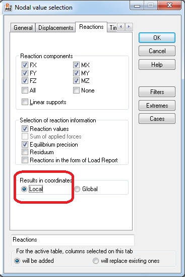

Nodal Displacement results are presented in Global CS
Reactions can be reported in Local coordinate system of support.

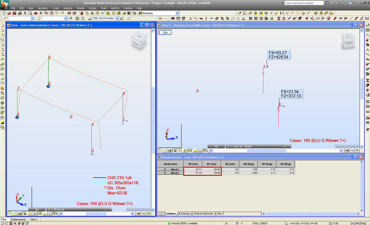

"Nodal Displacement results are presented in Global CS
Reactions can be reported in Local coordinate system of support."
I know that. My question is if is possible to get the Node Displacements / Rotations in some LOCAL CS which I define.
Take for example, when I need to define a simple pinned support is some LOCAL CS, maybe I don't need only the reactions values.
Like the example in the picture below, if nodes 3 and 7 represent the bearing equipment fixed on XX and free on YY oriented towards the frame center, besides the reaction values I have also to know  the displacements/rotations in those nodes, in that particular CS.
For this simple example, I should check the allowed displacements on YY, and get no displacements on XX.
Does the program store internally this data somewhere??...
I already try to get them by the bar deflection tables, but only the displacements on LOCAL CS of the bar are presented, don't let me to get rotations on start and end node of the bar in it LOCAL CS.
Please, if what I'm talking about is not possible, exploit some other indirect ways to get these rotations and illuminate me. Smiley Happy
