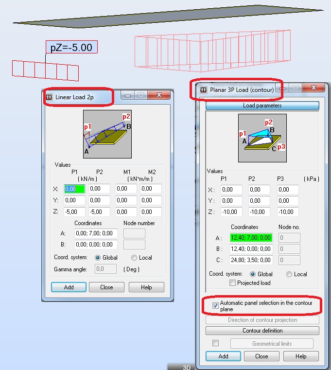

Is there anyway to avoid this type of loads display ( beside using uniform planr contour ) ?

It is like that if you use any 3dloads
So in case of contour loads please do not use Automatic Panel Selection...
Rafal Gaweda
Rafal.Gaweda
in reply to: Rafal.Gaweda
In case of having linear 2p loads in model you may convert them onto linear loads on egdes using attached macro.
(if this 2p load is not defined on real panel edge please remesh panel(s) after conversion)
