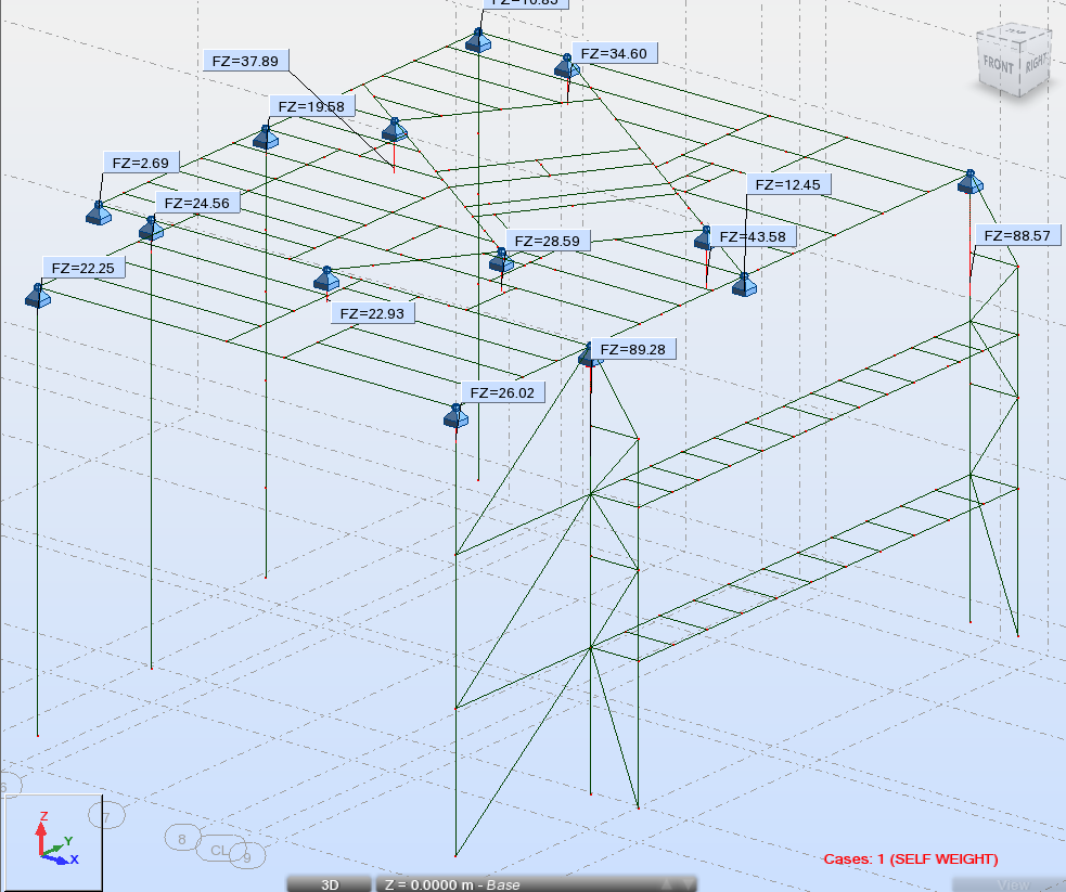

in reply to: Anonymous
I have attached a pic of what I have done, is this what you mean I should do (supports.png)? I have also attached a pic of how the lift will look like in my mind (supports2.png). Will it calculate the same thing ?
Message 9 of 94
Of course, the structure modelled in "supports2" can never work.
It can spin around the support with out ever stopping!
So no, it won't calculate the same thing.
okei, but if i had added a support that only takes forces from x and y directions in each corner at the bottom of the construction, and made sure that the reactions in the support is very low, so that the construction would not spin, would that be a possible solution? and make the support in top only takes forces in z-direction
Message 11 of 94
Perfect!  (well, most likely you will need a lateral support at at least 2 corners)

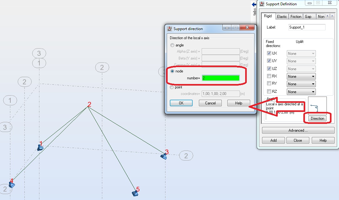

That´s not true.Forces on the inclined cables will produce horizontal forces on your structure. I would set the supports on the exact direction of the cables.Doing that you won´t need to add any other supports. For creating the " tricky" support ,create a new one fixing de X direction , then click on " direction" and give the coordinates of the point where the 4 cables will join.Then assign this support to your 4 lifting points.Check if they´re on the exact same direction of your cables.

in reply to: Rafacascudo
Should all of the "fixed directions" be checked? Like on the pic?
Message 14 of 94
Rafacascudo
No ,just Ux ,as long as you set the support local direction like I recommended
okei, but dose it look like i have done that according to the piecture i attached?
Message 16 of 94
Rafacascudo
Yes ,but it looks like the support directions are wrong, probabbly due to the fact you assigned a fixed support for them all

so now iam suppose to check of UX, UY and UZ? and not only UX?
