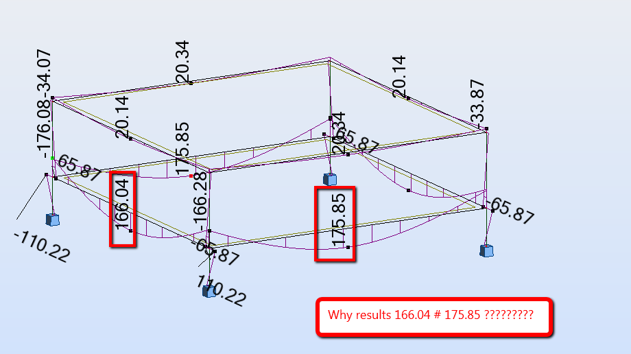

Hi. I is modol,all the same load, Why results other.
Please see picture
File is attachment.

Your columns are bigger and hence stiffer in one axis.  So the beam takes less moment due to variation in bending stiffness of column.  Make column square and bending moment is same.
You need to look more at your model and ask yourself more questions before posting.
