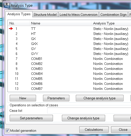

I do not see any problem with Newton Raphson algorithm.
calculation times:
all cases, Newton Raphson, Sparse Solver - 2227seconds
simple cases set as auxiliary, Newton Raphson, multithreaded solver - 1700seconds - such model here :
https://www.filemail.com/dl.aspx?id=JZOUWLOFNSEKABA
Rafal Gaweda

No support s in UX UY directions.
I suggest you to use Automatic solver - it will report instabilities in model.
Rafal Gaweda
