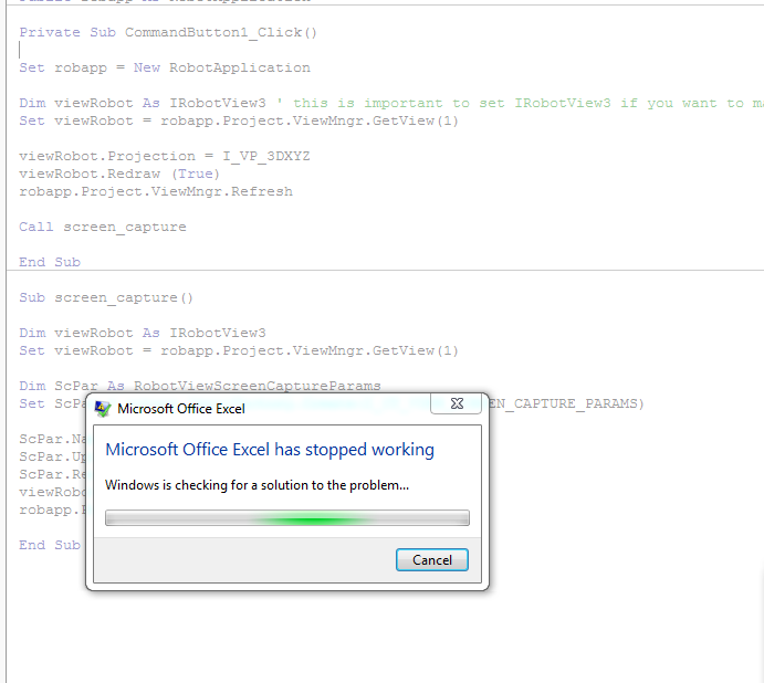

It's the same for me. Robot crash when ask for better resolution.
I think it's because my computer is not enough speed. When I do some break in the macro it's working. What do I need in the computer ?
I'm in windows seven 64bit with ARSA 2012 and Office 2010

Use from time to time DoEvents
or pause code in some places. Pause function dos not exist in VBA so write your own function - example below
This function pauses code for 5 seconds
Sub Wait()
    waitTime = 5
    Start = Timer
    While Timer < Start + waitTime
        DoEvents
    Wend
End Sub

View generation is one command \ line. After finishing it program steps to another code line.

So how explain that robot crash if I don't put sleeping times :
Sleep 33000  '33 secondes to generate a view of mobile loads
Sub cree_vues_resultats()
If Not Robapp.Visible Then
    Set Robapp = Nothing
    MsgBox "Open Robot", vbOKOnly, "ERROR"
    Exit Sub
End If
fichier_sortie = Range("AE16").Value
Dim mavueRobot As IRobotView3 ' this is important to set IRobotView3 if you want to make screen capture of this view
Set mavueRobot = Robapp.Project.ViewMngr.GetView(1) ' it seems CreateView makes this strange affect, use GetView instead
mavueRobot.ParamsDisplay.Set 68, False                               'symbole charges ponctuelles
