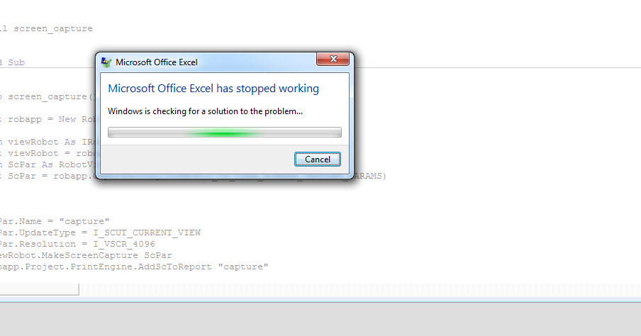

sorgjee
in reply to: Rafal.Gaweda
Hi Rafal,
The macro you provided runs, but as soon as it comes to the Resolution command it causes excel to crash.

Message 65 of 146
sorgjee
Yes, makes no difference. Still crashing the exact same way.

Message 71 of 146
sorgjee
Your EXACT code does not run due to a typo. Even without the typo, and using the rest of the code exactly as you've written, yes, it still crashes.error again.PNG
Regards,
Even
