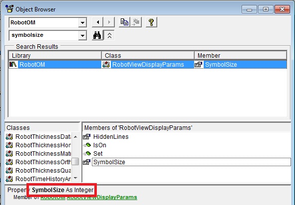

Re SymbolSize; is it correct that this only takes an integer, and that the symbolsize represented in Robot is ten times of this?
E.g. SymbolSize = 2 gives a symbol size in robot of 20.
Similarly SymbolSize = 1.5 gives 20, and SymbolSize = 1.4 give 10.
Message 56 of 146
Rafal.Gaweda
in reply to: Anonymous
and that the symbolsize represented in Robot is ten times of this?E.g. SymbolSize = 2 gives a symbol size in robot of 20.
Yes it is like that. 1 in API coresponds to 10 in Robot.
Rafal Gaweda
