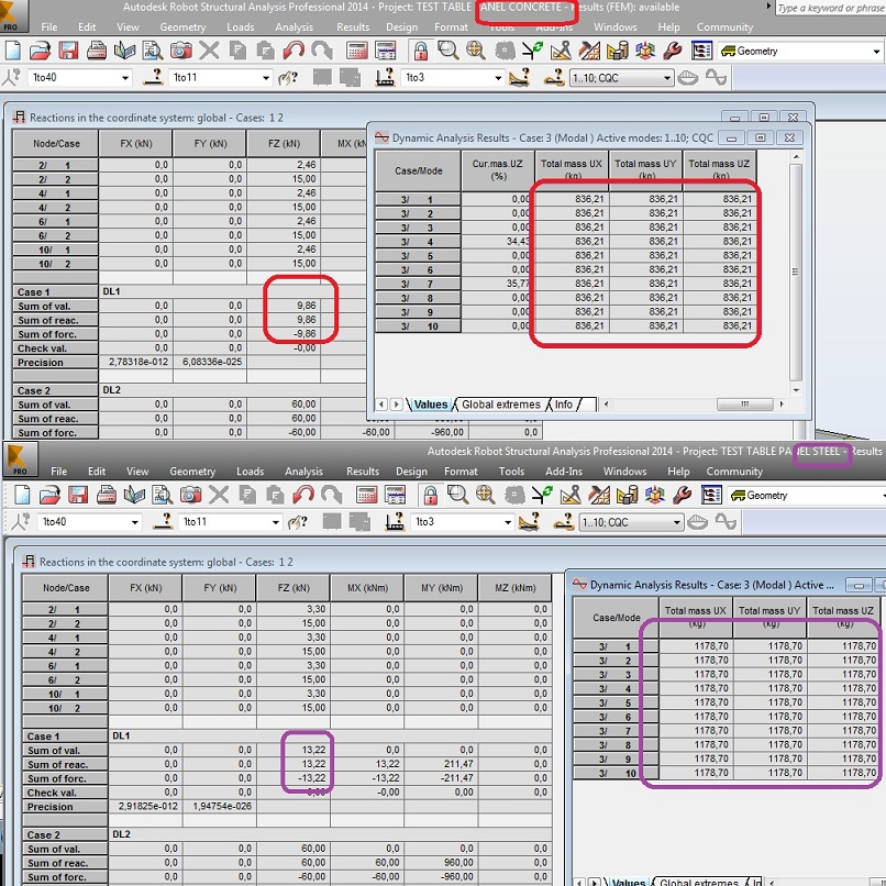

I did the following test. Two identical structures, the one has a concrete panel of 0.8cm thickness and the other steel panel of the same thickness. I asked from the programm to generate the self weight of the structure to mass in order to calculate the seismic equivelant loads. As you can see, the reactions of the seismic load are the same (???) as well as the total mass at modal analysis. How is this possible? The self weights of the two structures are not the same! The results are changing if I replace the steel bars with much heavier ones.

Rafal.Gaweda
Autodesk Support
Autodesk Support
My results
Rafal Gaweda

Rafal.Gaweda
Autodesk Support
Autodesk Support
Load to mass conversion worked wrong on panles \ claddings with simplified loads generation.
Use Analytical. (Corrected in 2014)
Rafal Gaweda
