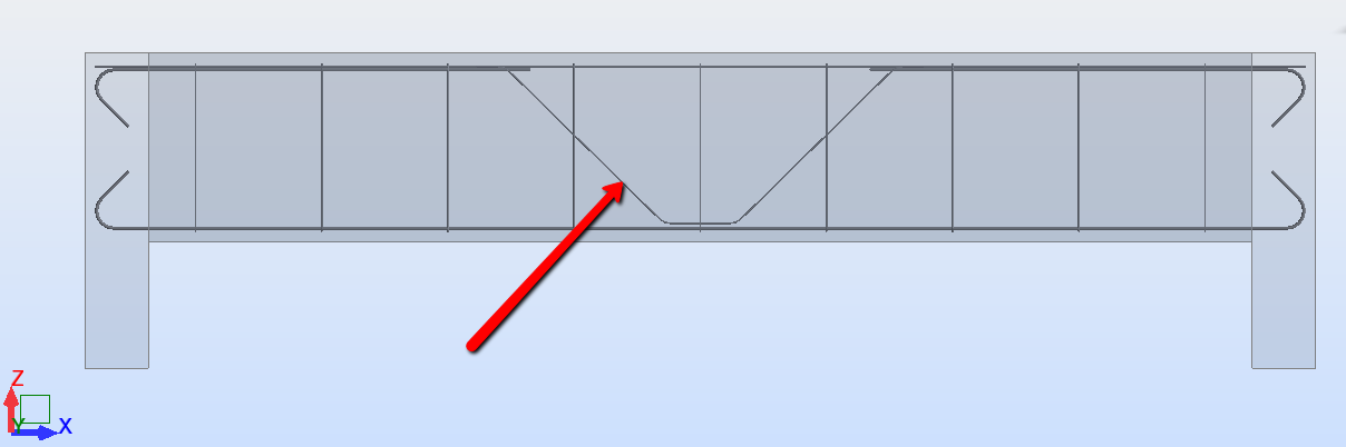

I assume by your explanation that you want to have reinforcement like this:
Right?

It is exactlly what i want

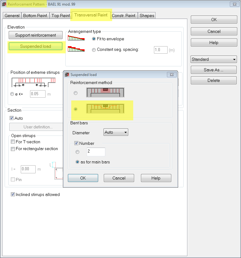

1- you've to check the reinforcement pattern:

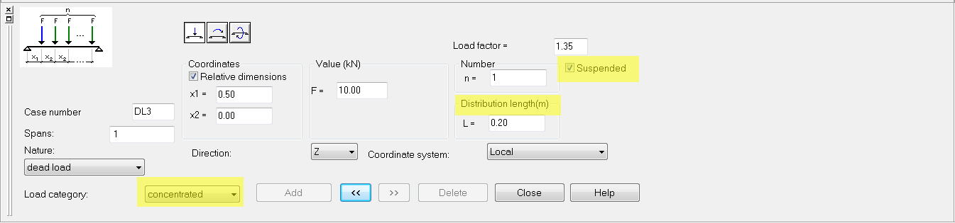

2- add a concentrated load, switch on the suspended option and enter the  distribution lenght:
You'll find attached an example done on RSA2011_SP6, if you don't install the last updates of RSA2011, please check them here: http://usa.autodesk.com/adsk/servlet/ps/dl/index?siteID=123112&id=2334435&linkID=13140816

I find the problem
It is a bug in the definition of the suspended load, When i use relatived dimension to define loads cordinates it works
But When the option "relatived dimension" is disable bent bars can't be used

You're right, the workaround for this is to enter the real position of the concentrated load and switch on after the "Relative dimensions" to convert this distance automatically, thank you for your help and i will give you a kudo for this 🙂
