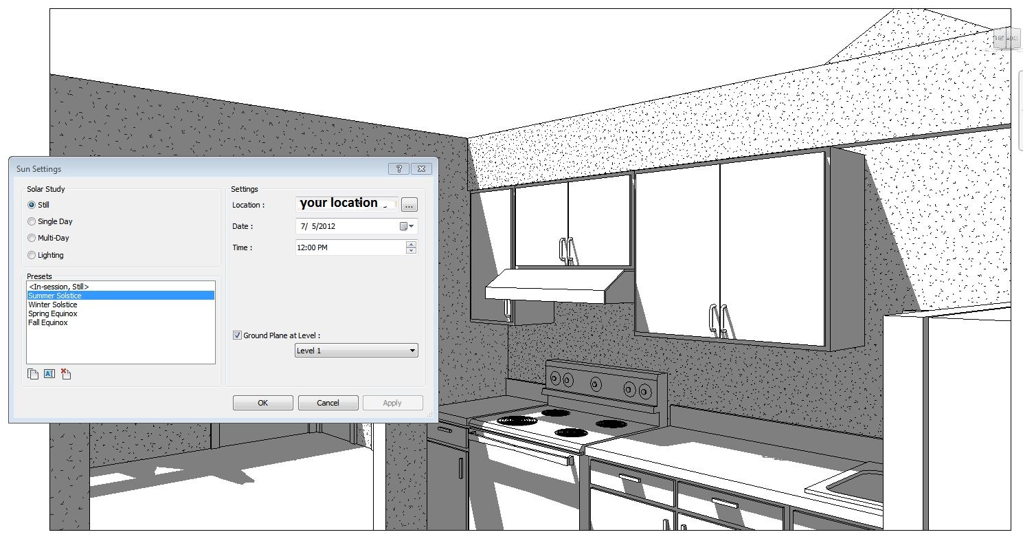

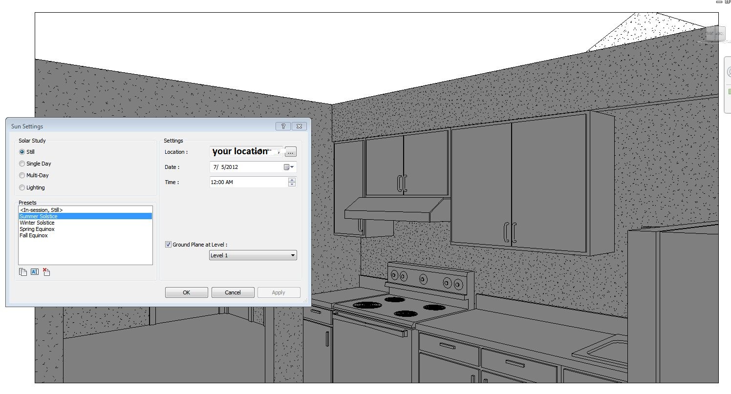

Where is the sun placement? What are your sun setting at? Do  you have the right location, right date and time?
Those will also make a difference. I have added 2 images - one at noon and the other at midnight - you can see the shadow difference.
LD
