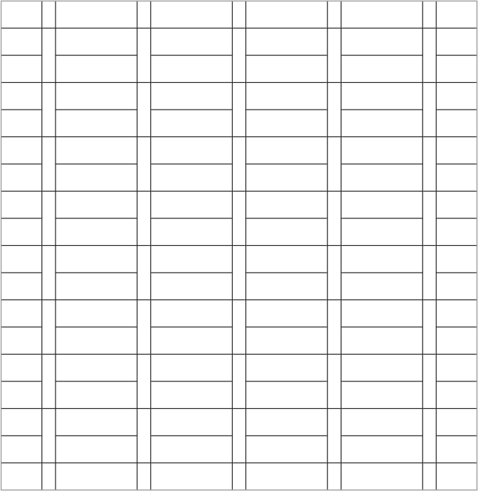

I'm currently working on a ceiling grid pattern that has 2 parallel 2'x6' with a  1'x4' grid perpendicular to it.
I tried to wrap my head around the discussions but I think the solution to mine can be somewhat similar but more complicated as it is. Can you help me with this, please? I attached an image of what I'm trying to achieve.
Thanks.
Message 20 of 29
David_W_Koch
in reply to: miko.g
Try this:
;%VERSION=3.0
;%UNITS=INCH
*ClgGrid_2x6_1x4, Grid with stacked 2'x6' panels alternating with 1'x4' panels
;%TYPE=MODEL
0,    0,0,   0,48
0,    0,24,  0,48,  72,-12
90,   0,0,   0,84
90,  72,0,   0,84
Use Notepad to save that to a file called ClgGrid_2x6_1x4.pat (make certain the extension is pat, and not txt).  If you would prefer a different name, change ClgGrid_2x6_1x4 in the text above to your preferred name and use that as the name of your file (with a pat extension).2019-08-01_CustomClgGridHatchPatternResult.png
