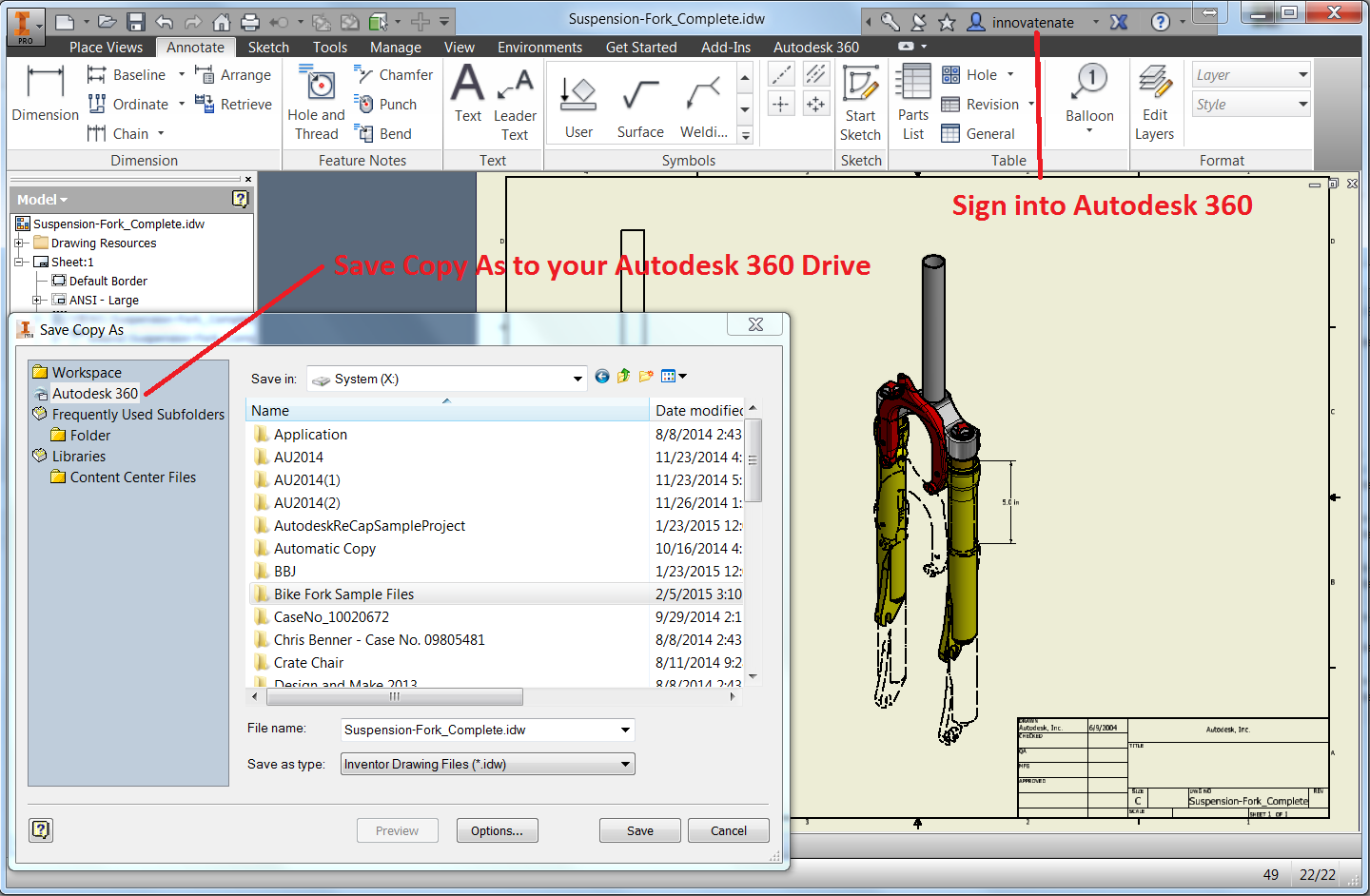

In honor of the announcement of Fusion 360 becoming avaialble to hundred of thousands of Product Design Suite Subscribers, here's tip on how to transfer data from Inventor 2015 into Fusion 360 via Autodesk 360.
1. With a File open in Inventor 2015, select the Save Copy As Command. Note that you need to be signed into Autodesk 360 with an Internet connection.
