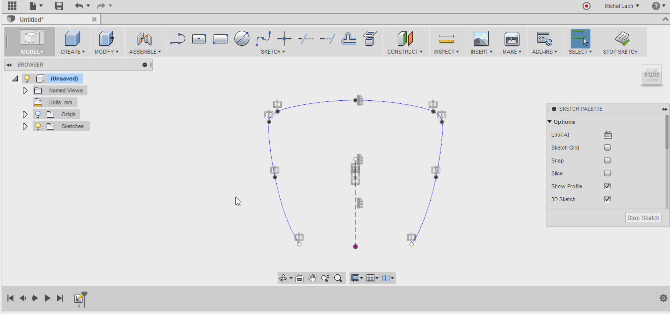

Thank you in adance for your assistance. I'm a new user to Fusion 360 with some experience using Inventor Pro. The object that I'm creating will be used to create a mold for for molded plywood. This molded plywood piece will then be cut into eyewear frames.
1. It is important that the sketch lines which were created to make the 3D object are smooth so that the mold has a consistent shape.How can I make sure the lines ae smooth? Do I need to use the smooth tool for this? It was not clear how to actually use this tool from tutorials.
2. It is also important that I add constrainsts that allow the shape of the mold to be easily modified. Can you please provide recommendations for what constrainst would be most useful for making small changes to the radius of the curves, and the dimensions of the overall piece?
 I have attached a picture of the final molded wood piece that I'm working to create along with a screen shot of the sketch lines that I'm referring to.

Hi Matthew, first thing I need to say is that you have attached the same photo 3 times. Nevertheless I assume that your part is made of 3 arcs that you would like to blend.
Working with curves is bit tricky in Fusion, especially if we want to make nice transition with arcs and lines. Why, mainly because we have only C2/G2 continuity, which gives rather coarse tarnsition here is simple example (look at curvature comb):
Before I'll show you to how make transition like that, much nicer, I would like to show you how to get perfectly smooth curve. To acomplish that you need to create desired shape with a single spline, that of course means you have to sacrifice some of your first ideas. There will be no arcs only curve close to arc. I don't know if it's possible for you to consider that, but if here's an example:
1. Draw raw shape of your part.
2. Draw centerline (you can make it constuction line, you know dashed one), apply symmetry constraints using centerline (choose Symmetry command from SKETCH PALLET, then pick two points, then centerline).
3. Turn on curvature comb to find shape that will be close enough to arcs at certain parts.surf4.gif
5. As a resault you'll get smooth surface.
6. Next you would need to thicken your surface, you can also apply some other constraints, like dimentions, but you should be able to adjust your model only with those symmetries applied.
