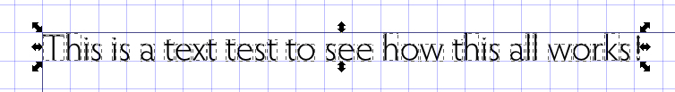

Ok now we have our 1/4in high text, all we need to do now is position it and ungroup it and export. If you place your mouse cursor over the text it will turn into a hand and you can left click and drag it to the top left corner: it should snap into place when you get close enough. Now with the text still selected click Object -> Ungroup and you should see little box around each letter like this:

Click ok and check your text to the grid and make sure its 0.25in tall now. From here we can do the press pull select the letters and set the height, then click ok. You should have something like this, nice clean letters that don't need any clean up:
