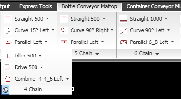

Total n00b trying to use .net to create ribbon bar addins
Ok im totally lost here with this.  Figured this after at least getting over the hurdle of trying to set up the project and all would be much easier to use and deploy (maybe even faster in AutoCAD) than what im trying to do right now using CUI files which can take 30-45 seconds to load each ribbon bar.
Trying to create extra ribbon tabs and pannels each with multiple items in drop down windows and such.  Basically im trying to get rid of the tool pallet function and replace it with this item.  So far I've done this just using the CUI editor in autocad but its time consuming (not easy to switch between macro's) and takes long to load on the first launch of it.
I really don't know much about VB or .net or anything.  Though I have been learning more recently, with a little bit in excel trying to make customized documents for my department.  I have AutoCAD 2010, and have Visual Studio 2010 Professional.  Any help would be apperciated, expecially if there is some templates that I could load easily, currently not having any luck with the files from the website ObjectARX 2010 or a AutoCAD2010VBNetTemplateSetup.zip I got from another site.
7 REPLIES 7
Message 2 of 8
deathman20
in reply to: deathman20
Well at least I got a template up and runnig at least to debug mode now.
Another question I have is that is it possible to have a .dll (weather the one the main project one or a seperate file) load images into them?
Looking at loading some 2500 images maybe more.  Got about 500 to add right away and others to add over time.
Thats a small sample of what im doing.  Under each pull down there can be another 5-20 options.  Probably 10-12 tabs, each with 20 or so panels.  Any help pointing me into the right direction would be great!
All that was done in the autocad CUI, though its buggy and if it can be transfered between AutoCAD revs easier later on it would be great, and probably easier to edit for future updates.
