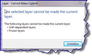

I guess you want something that is not possible for AutoCAD. Have you tried it in the layer manager to make a layer current that's origin is within an external database? I get that message when I try to do that:
Whatfor is it necessary to your tool/your application to try to do that? If you want to draw on that layer you will have to create the objects in another database (in the Db from your XRef, and not in the Db of your drawing you have opened in the drawing editor). Maybe there will that some people come up with ideas if you describe your needs!
