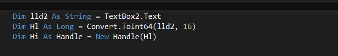

I tried your suggestion as below
but i have this error for Pss type

The SetImpliedSeelction takes an ObjectIdCollection as it's argument. The following is close to what you will need, but I normally use c# so not sure of the syntax on VB
Dim id as ObjectId
id = Db.GetObjectId(False, Hi, 0)
Dim idColl as new ObjectIdCollection
idColl.Add(id)
ed.SetImpliedSelection(idColl)
Dim ss as SelectionSet = ed.SelectImplied().Value
But if what you are after is the selected object, there is no need to use the Set/Select Implied since you already have the ObjectId.

Thank you Dr. Jeff,
your suggestion was solve the issue as you see below
