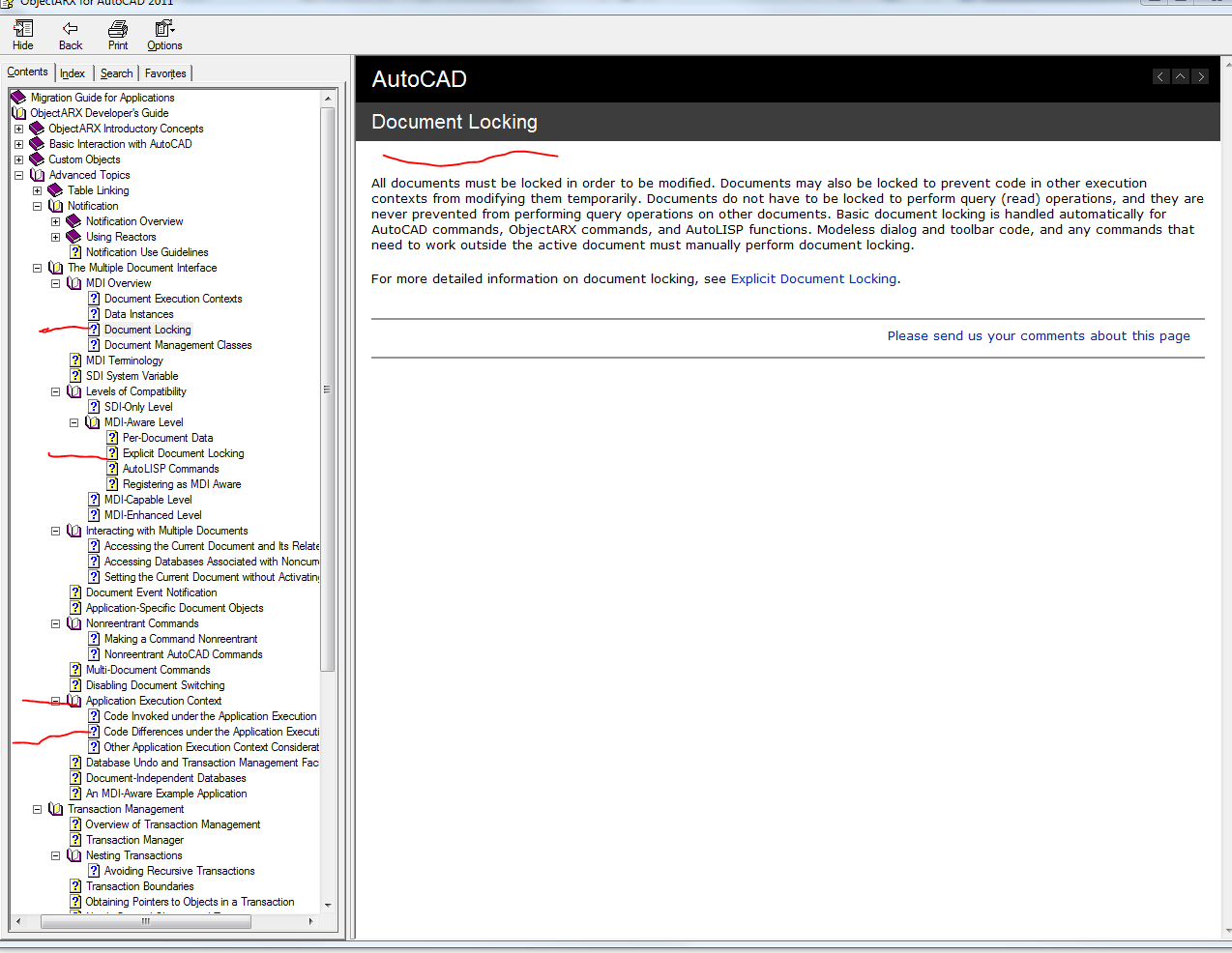

in reply to: Anonymous
Have a look at the arxdoc.chm
1350i488439DA21C6B39E
