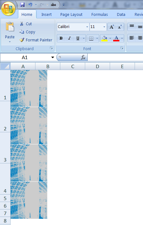

I am playing with the 2012 tabular report and excel import options. When I import into excel, the none of the images are properly aligned in the cells.
I am going to keep messing with excel to get it right, but if anyone else has run across a solution, please let me know.

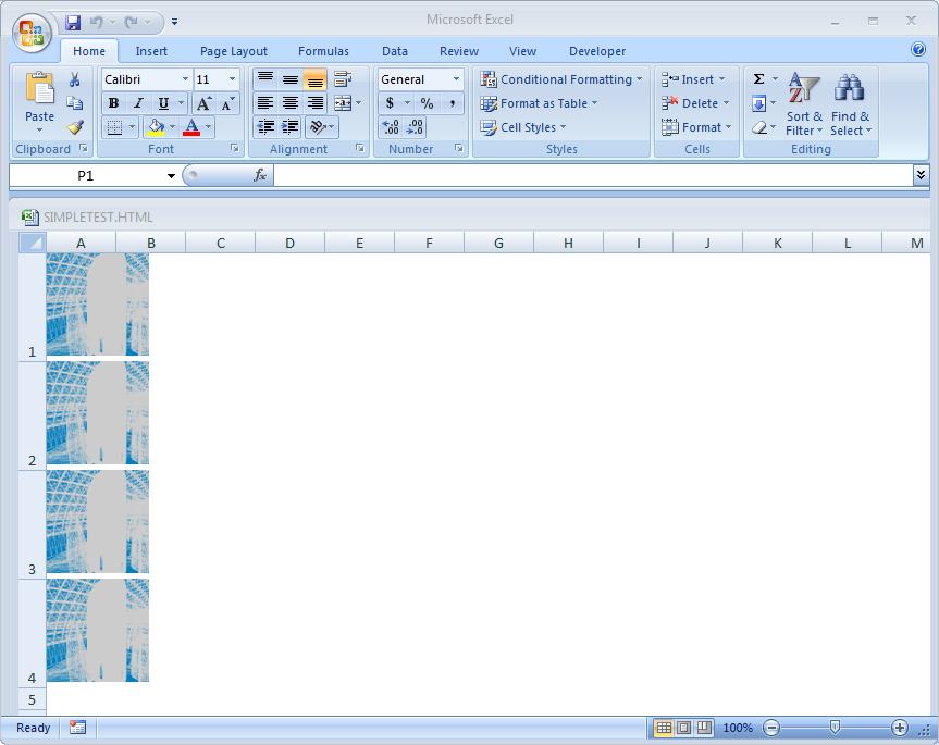

I’ve attached a test file SIMPLETEST.HTML along with one of your images cd000001.jpg that should be placed in the same folder.  Try opening this SIMPLETEST.HTML in Excel.  It should look like this:

Could you post a screenshot of what you see in Excel when you open the SIMPLETEST.HTML file.  I am testing on MS Excel 2007, and the screenshot I previously posted is how it looks when I open it on my end.

Message 8 of 12

I think I may have found the issue:  Please check your DPI setting in Control Panel by opening Control Panel > Appearance and Personalization > Display.
I think yours is set to Medium, as when I tested with this setting, I see the same results in Excel as your screenshots.
Try changing the setting to Smaller 100% and log off/on so the setting takes effect.  Then try opening the HTML files in Excel.
Please let us know if this solves the issue on your end.
