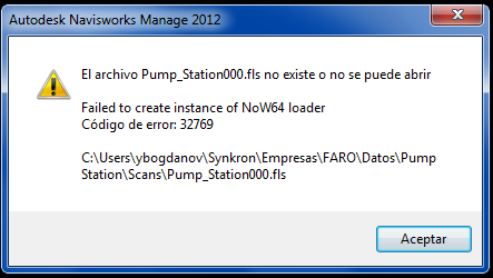

 I want to open directly fls files, and in the Navisworks add menu there are this format in the list. But when I open one there are this bug:

Hi Yury,
Is this a Faro 4.8 file? I believe this should be resolved in Navisworks 2012 by installing the Service Pack 1 from below.
http://usa.autodesk.com/adsk/servlet/ps/dl/item?siteID=123112&id=17757207&linkID=10382102
More details of the fixes can be found here: -
http://beyonddesign.typepad.com/posts/2011/09/navisworks-2012-service-pack-1-available-now.html
If this doesn't resolve the issue please let us know and let us know if it is a different error.
