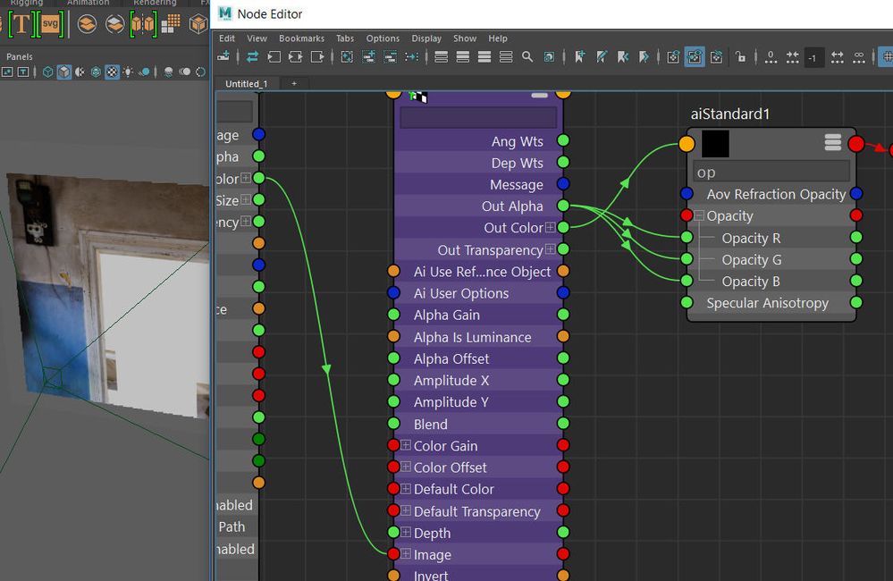

There are different methods to get a connection to the opacity attribute, just one example (right-mouse-click "Show All Attributes"):

Message 10 of 18
mspeer
Hi!
You need to click directly on a node next to (or on) the icon, this is a context menu. In my Screenshot you can see where i clicked with the mouse (midpoint of the menu).

Message 12 of 18
mspeer
Hi!
You will not see the effect in Viewport 2.0, at least with Maya 2017. Keep in mind that there are still some limitations when using Arnold in Maya. The opacity attribute of the aiStandard material is not supported in Viewport 2.0 (with Maya 2017).
But there is a workaround, set one material for Maya and an other for Arnold:
