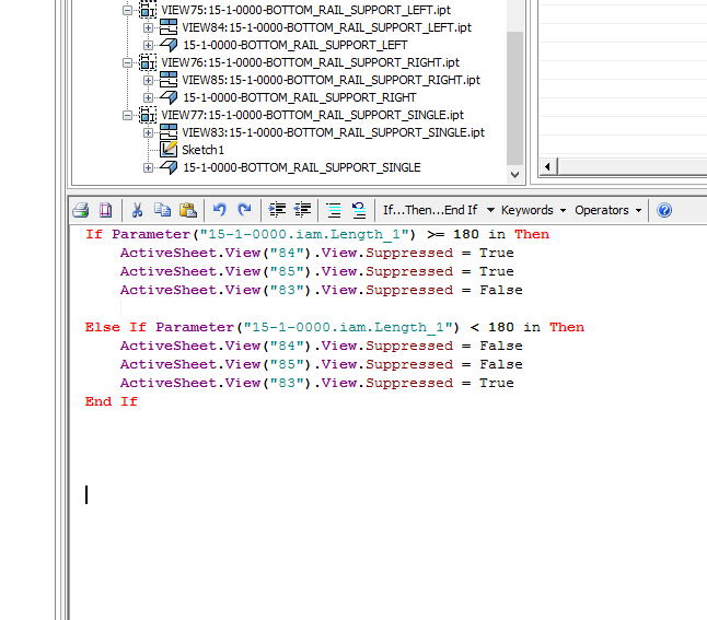

I have 3 parts, under a parameter I want it to surpress some of them. What is wrong with the way I'm doing this, I've used this code to surpress section views on .idws before so is there a different rule I have to write because these aren't section views?
I tired doing both sets of numbers, like for the first one I tried 75 and 84, neither worked.

Add "VIEW" next to the view number in your code:
SyntaxEditor Code Snippet
ActiveSheet
.View("VIEW84").View.Suppressed = True
