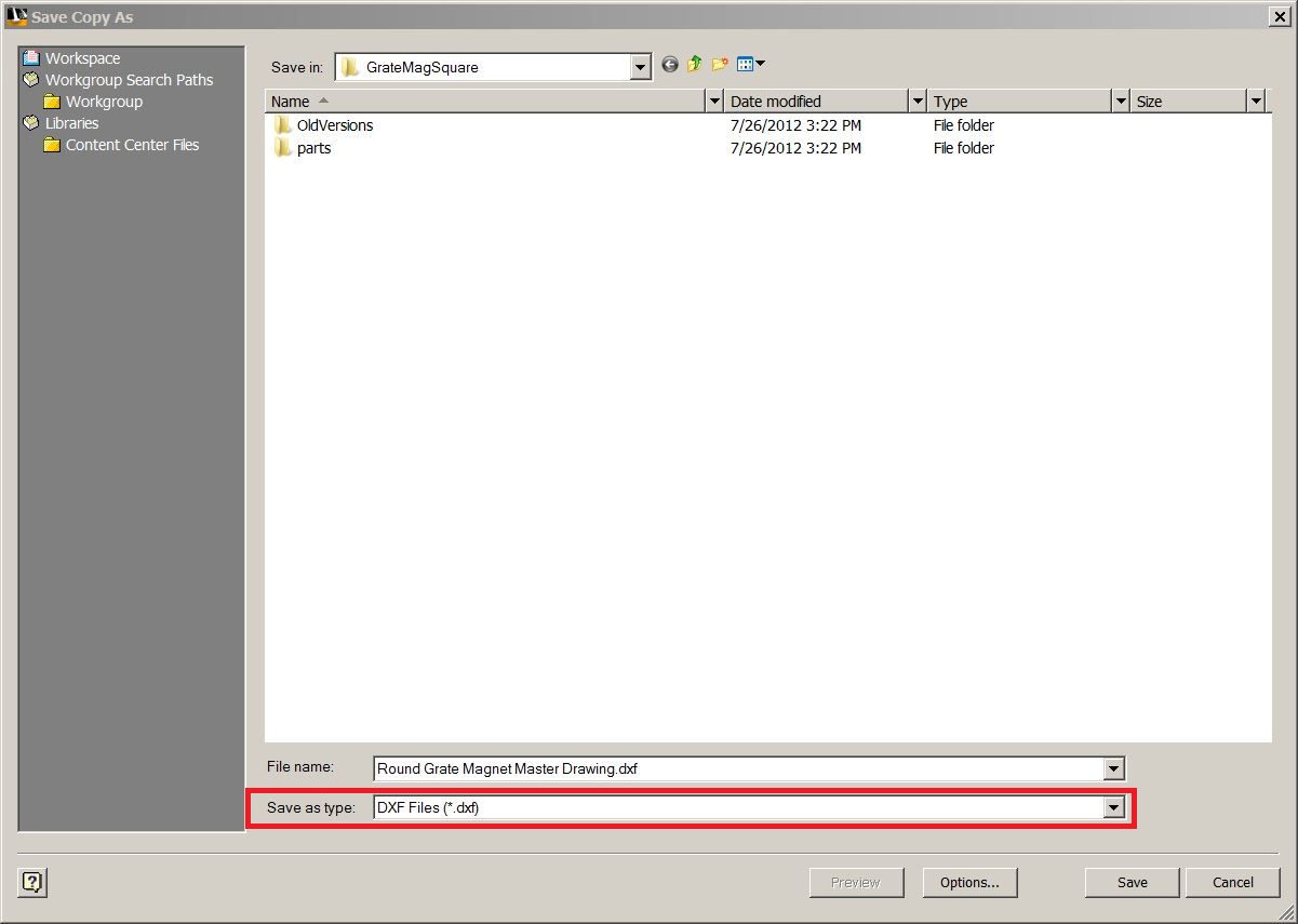

I've been looking all over the forum but cannot find any answers as to how I can export my drawing in DXF. I have tried the options for dwg files but am not finding the option to export as dxf. Please- a little help would be greatly apprecited.

Try "Save As > Save Copy As", this should allow you to get the DXF file you need.

mrattray
in reply to: KevinLi-Autodesk

in reply to: SBix26
You don't. I don't know where Kevin is getting this nugget from, but that screen cap I posted is of Inventor exporting a DXF.

mrattray

in reply to: blair
I'm not sure, either, what Kevin is referring to, but I also confirmed that drawing export to DXF in 2013 works as it has in previous versions.  Blair, I've always been able to export DXF with Model Geometry Only; in fact if I choose to scale to 1:1 in Model Space, Model Geometry Only is forced.

KevinLi-Autodesk
in reply to: blair
Hi Guys,
I am so sorry that I made a mistake here, Inventor supports to export DRAWING to DXF format via Save As -> Save Copy As -> DXF Files dropdown.
