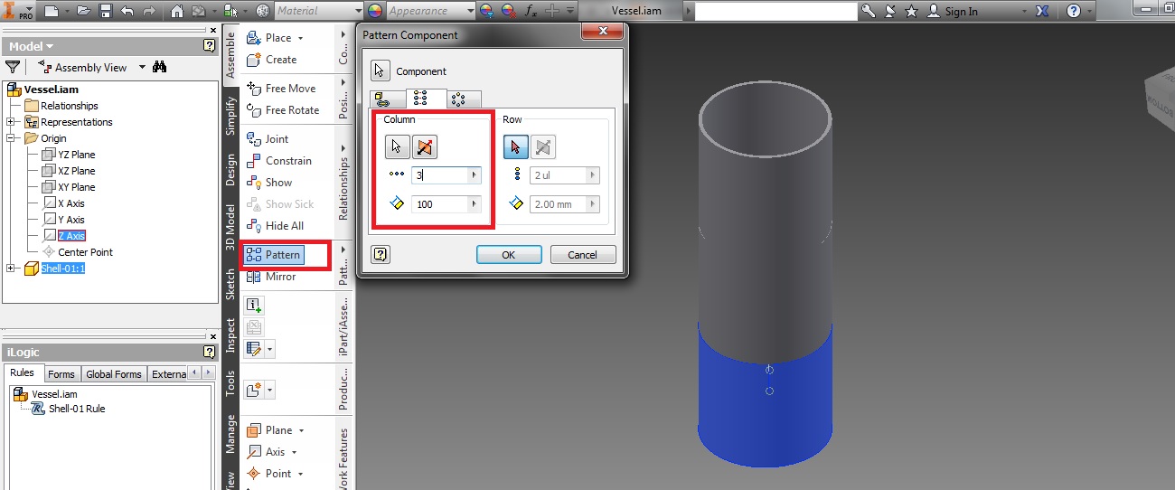

I am working on Vessel Shell assembly with variable shell height and wall thickness using ilogic, and i am trying this using array tool. can any one help me how i define perameter in array using ilogic to allow me different height and wall thickness in array.
Component key names are
Shell Diameter = ID
Shell Height = HT
Shell wall Thickness = THK
Array tool using column number of shell n=4 or 5 or 6 etc.
Does anyone know to do this with ilogic?

jam_bhatti
@ Curtis_Waguespack/mdavis22569
i appreciate your quick feedback and please accept my apology to i cannot convey correctly the problem what i want
find the attached image to express that problem in light of my first post.
The diameter remain same, only height and thickness of shall value need to be change in component pattern stages.
i hope it can be possible through ilogic/vb.
