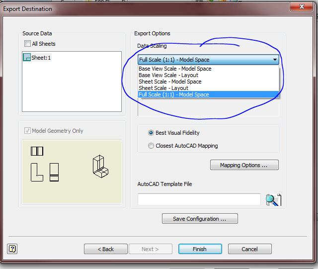

I mean in this area here if you did not pick the right option it will scale in autocad..

I have had this issue.  And it's caused by what others have mentioned in this message.  When you save-as dwg in Inventor, some of the settings will scale the Inventor model to the idw view scale during the export to dwg.  If you select model 1:1 setting Inventor it won't do this.  However, the dwg will contain only the model and no dimensions/annotations/notes, etc.

I think your having this issue because you have multiple views with different scales on the same IDW.  The DWG will read the first inserted view's scale and that will be the only one that will dimension correctly.
