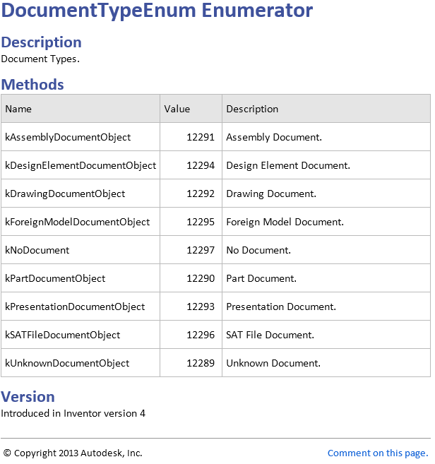

How Can I get the file type of first file?
I can get it the right letter after I get the fullfilename after run below Snippet which you gave to me.
oFirstName = oAsmComp.Occurrences(1).ReferencedFileDescriptor.FullFileName
But do we have a simple way to get it?
I tried to use this snippet, it does not work. Do you have any simple way? Thanks lot for your help in advanced.
oFirstType = oAsmComp.Occurrences(1).ReferencedFileDescriptor.FileType

Hi Rich.  You can use the following to get the document type:
oFirstType = oAsmComp.Occurrences(1).DefinitionDocumentType
This returns an enumerator (enum), which is a numeric constant that represents something.  In this case, it returns a DocumentTypeEnum, which as you might guess represents a type of document.  According to the API help documentation, the different values for DocumentTypeEnum and what they represent are given in the image below:
The following is an example of how you might use this enum in your code:
If oFirstType = DocumentTypeEnum.kAssemblyDocumentObject Then
    'do some stuff
End If
