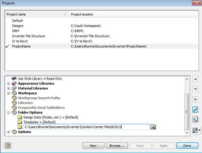

Just helped a customer with this.
There is no need to create a new project file or do a Pack & Go.
The issue is that when a Project's Folder Options > Content Center Files path = [Default], Showcase does not know how to find the Content Center Files.
The way Inventor works, if this propety has a value of [Default], then Inventor get's the location from Ribbon > Tools > Application Options > File tab > Default Content Center Files.
How to fix for End-User:
  1. In the Project dialog, select the Project exhibiting the issue.
  2. Expand the Folder Options
  3. Hover your mouse over the Content Center Files entry, must position over the text, to see the location currently defined by [Default] in a tooltip.
  4. Select the Content Center Files entry, then click Edit Selected Item (the pencil icon to the right)
  5. The current [Default] value should now be ready for editing. Position the cursor at the end of the text and just delete the last backslash, then press the ENTER key.
  6. Click the Save button.
To test that the value held, select a different project from the list, then reselect the edited project.  Expand the Folder Options and verify the full, default path is shown.
How Showcase should function (For Autodesk):
If Project file is using [Default]:
  1. Under the "HKEY_CURRENT_USER\Software\Autodesk\Inventor\Current Version" key, read the value of "RegistryVersion"
  2. Under the "HKEY_CURRENT_USER\Software\Autodesk\Inventor\<RegistryVersionValue>\System\Preferences\File" key, read the value of "C:\Program Files\Autodesk\Inventor 2013\Bin\Inventor.exe:ContentCenterDir"
Ronnie Wilkins, Jr.

If you follow the instructions in my post, then you should be seeing everything in Showcase.  I just did a test on my machine and everything came through just fine.
