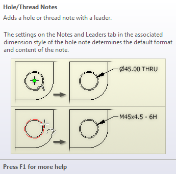

And, whilst we’re discussing that very long ‘Inventor Wish-list’, I wish we had that Hole/Thread note leader behave like a proper leader – it even shows like a normal leader when hovering over the button - but no dice, we still have to put up with the straight single line leader which places the text at a mighty ugly angle most of the time. After all these years… come on Autodesk, you can do it!

(and the hole note leaders - that's your dimension style, you can change it any time you want)
I stand corrected on my issue with the leaders - thanks for pointing that out.
That's so much better!
