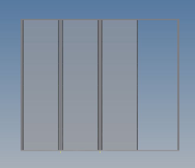

Hello i made this rule ti surpress my parts (see the picture):
I made this code but it doesent work when i edit my parameters from excel:
If Parameter("Mittelpfosten_vorhanden")=0 Then
Component.IsActive("Mittelpfosten:1") = False
Component.IsActive("Mittelpfosten:2") = False
Component.IsActive("Mittelpfosten:3") = False
End If
If Parameter("Mittelpfosten_vorhanden")=1 Then
Component.IsActive("Mittelpfosten:1") = True
End If
If Parameter("Mittelpfosten_vorhanden")=2 Then
Component.IsActive("Mittelpfosten:2") = True
End If
If Parameter("Mittelpfosten_vorhanden")=3 Then
End If
Can you help me?

rossano_praderi
This is faster, much more easy to read and to implement.
Select Case Parameter("Mittelpfosten_vorhanden")
	Case 0
	Case 1
	Case 2
	Case 3
End Select

Message 14 of 20
CCarreiras
I think the problem isn't the  rule, but in the parameter.
If you change the parameter, the rule works well.
CCarreiras
