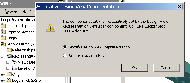

I feel like I've done this in the past, but I can't seem to find a way to do it now,  and I can't find an example anywhere, so I thought I'd ask and see if anyone could help.
What I'm trying to do is turn off the visibility of a part in a subassembly, from the top level assembly, but do so by modifying the sub assembly's design veiw rep. Attached is a simple example data set with a couple of rules.
When I run the rule called "Turn Off" it turns the visibility of the part off from the top level assembly, but if you open the subassembly (Lego Assembly2) you will see that the part is not turned off, and the view representation called "Default" has not been modified.
If you walk through this same workflow manually, by right-clicking on the part and turning it off while the subassembly is set to a View Rep, you receive a message prompt asking if you want to modify the view rep or make it not associative.
So the goal is to turn off the part in the subassembly by updating the Veiw Represetnation. Am I just overlooking something, or is there not a way to do this?

Curtis,
See the attached zip. I think I've modified the Turn-Off rule to perform the way you were expecting. Not a lot of care taken with the code and I don't have much experience with iLogic (yikes, no intellisense). I did not modify the Turn-On rule.
Neil

I'm posting the code here in case it helps someone's search in the future.
' set a reference to the assembly component definintion.
Dim oAsmCompDef As AssemblyComponentDefinition
oAsmCompDef = ThisApplication.ActiveDocument.ComponentDefinition
'define the Component Occurrence collection
Dim oCompOcc As Inventor.ComponentOccurrence
Dim oSubCompOcc As Inventor.ComponentOccurrence
'set top level view rep to Default
oAsmCompDef.RepresentationsManager.DesignViewRepresentations.Item("Default").activate
For Each oCompOcc in oAsmCompDef.Occurrences
	oCompOcc.SetDesignViewRepresentation("Default",, True) 'True sets the view rep to be associative
Next
Dim occurDocDef as AssemblyComponentDefinition
'modify actual subassembly document
If oCompOcc.DefinitionDocumentType = DocumentTypeEnum.kAssemblyDocumentObject Then
	'get assembly component defintion in the subassembly document
	occurDocDef = oCompOcc.Definition
	For Each oSubCompOcc in occurDocDef.Occurrences
		If oSubCompOcc.Name = "Lego Brick 2x2:2" Then
			oSubCompOcc.Visible = False
		End If
	Next
End If
