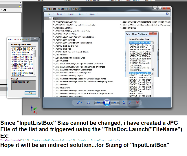

Note: I am posting this, since it can be useful for others. who search for the same.
Since i got information by this forum, that InputListBox Size cannot be modified.
I have used an indirect method for selection.
1. Created JPG of the Full File Name
2. Triggered the JPG File
ThisDoc.Launch("path\file.ext")
3. Then Triggered
InputListBox
4. User can swap inventor and JPG Image Default browser to understand, what to select.
Hope it will be useful
