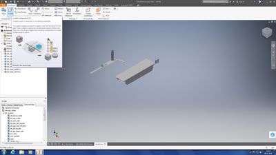

arge
hi curtis
My rule subject ;  custom properties of the all parts in assembly. Miscalculating assemblies built with some methods. Examples in JPEG files.
What could be the reason? help please  thanksdemote create1.jpgdemote create2.jpgdemote create3.jpgdragging create 1.jpgdragging create 2.jpgdragging create 3.jpgdragging create 4.jpgdragging in place create 1.jpgdragging in place create 2.jpgplace create 1.jpgplace create 2.jpgplace create 3.jpgplace create 4.jpgrun  Rule for all assembly.jpg
