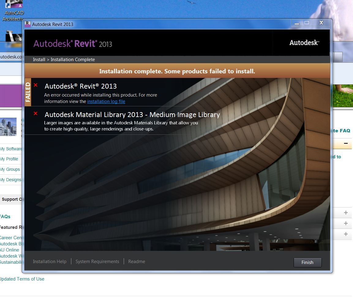

I am attempting to install Revit 2013 and I'm receiving the following error message. I've pasted the information log as well. I don't know what to uninstall from my c drive to get this to work. PLEASE HELP!!!!
2012/12/13:13:55:56 jon emari JONEMARI-VAIO === Setup started on JONEMARI-VAIO by jon emari === 2012/12/13:13:55:56 jon emari JONEMARI-VAIO Launch 2012/12/13:13:55:56 jon emari JONEMARI-VAIO CommandLine /url "http://studentsdownload.autodesk.com/SWDLDDLM/2013/RVT/WI/Autodesk_Revit_2013_English_Win_32_64bit_w..." /SN 900-20635048 /PK 829E1 /student /skipEULA /akamai /auth  /sid   2012/12/13:13:57:15 jon emari JONEMARI-VAIO === Setup ended ===

Are you connected to the Internet during the install so it can complete the full download?

Yes. At first I was doing it wireless, but then I connected my ethernet cable and the same error occurred.

Hello. The failure is with your method of installation, downloading and installing at the same time. Your machine is just not linking this particular install process, so you need to download the program first, and then try to install.
  1. Go to http://www.autodesk.com
  2. At the bottom of the page, beneath "Help and Support" click "Customer Service"
  3. Click the "Ask" button for the "Virtual Agent"
  4. Once the Virtual Agent opens, click "Downloading and Installation"
  5. Click "Software Download links"
  6. Click "I need to redownload my product"
  7. Select the appropriate product and download
Assuming you download these files completely, you should be able to install from here.
