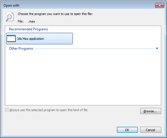

Why do .max files not recognize my 3ds Max 2011 that is installed and working fine (Using Windows 7)? If I try to search for 3ds Max 2011 to "Open with..." it does not show up on the list to link .max files with 3ds Max 2011, and when I find the application 3dsmax.exe in Program Files it seems to be missing its icon. Selecting the application itself also does not link them. The only way I can work with .max files is to open the file inside 3ds max, which is less convenient. The shortcut icons are working and again the program itself works fine. How do I fix this?
23,466 Views
13 Replies
Replies (13)
Message 2 of 14
Still looking for a solution, here is some more information:
I can certainly search for it and discover the application. If I try to select it and hit OK, it does nothing, normally it would show up on the list and you can make the file associated with that application from there on. However, that is not working. I also find it wierd that the actual 3dsmax.exe application in the 2011 (32 and 64 bit) folders in Program files have a generic "window-look" icon beside the file name instead of the normal 3ds max logo for its icon. Yet the shortcuts and shortcut icons work fine. Trying to browse for the program and selecting the shortcut comes with the same unwanted results. I attached an image for more clarity.
(I have the .max files linked to the max.ico which I know is incorrect however it visually helps me distinguish the file type for the time being. I also tried to Repair 64-bit Max, nothing changes).

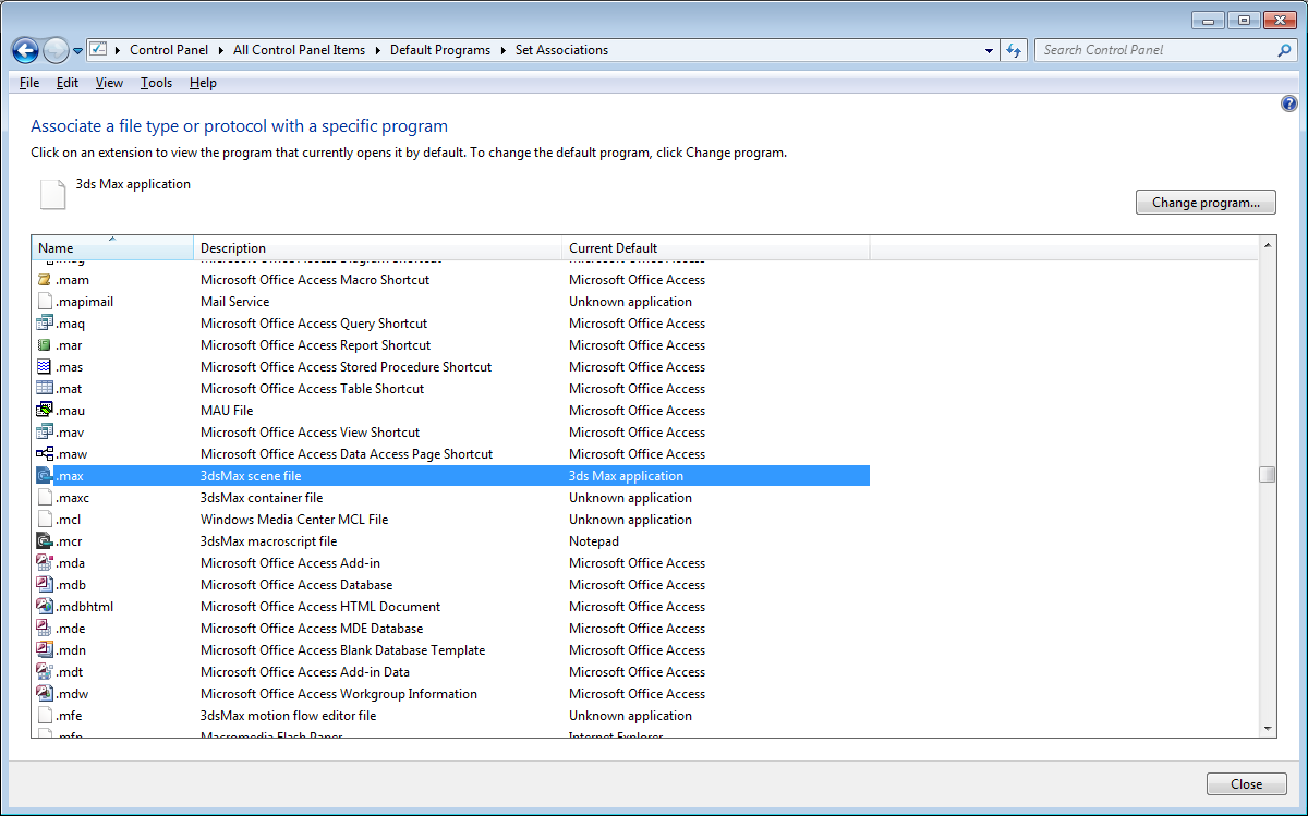

DouglasLauritsen
What does windows say for .max in Control Panel > All Control Panel Items > Default Programs > Associate a file type or Protocol with a program?
It should say 3ds Max application.

Unfortunately, in my situation it doesn't work out that well. The first image shows that .max is assosciated with the max.ico which i set up.
Observing the max1.jpg image attached you will notice:
When attemping to choose the 3dsmax appliaction, the Open with window opens with those options (which are other programs that I changed the .max files program associated programs respectively as I was trying to test my options). Browsing for the 3dsmax.exe.
Observing the max2.jpg image attached you will notice:
The situation after Open 3dsmax.exe to try and set it as the default open with program. No changes are made in the Open with window.

Ok, you have somehow associated the file with an icon file for 3ds Max. You can change this:
  1. Open the Windows Control Panel
  2. Choose Default Programs
  3. Choose “Associate a file type or protocol with a program”
  4. Select the .max file type
  5. Click the “Change program” button
  6. In the “Open with” dialog click the Browse button
  7. Browse to “C:\Program Files\Autodesk\3ds Max 2011”
  8. Select “3dsmax.exe”
  9. Click Open

I have done those steps many times, however, it just does not change anything after I select 3dsmax.exe from “C:\Program Files\Autodesk\3ds Max 2011”. Is there any way to find out if there is a conflicting or currupt file that I may need to change to get things working? Reinstalling has been done and it changed nothing.

I managed to fix the major problem after some hunting in Windows tech support forums after reading that last post. It was worth a try and indeed the problem was in the Registry. So I opened the Registry Editor and found that the open command to 3ds Max was pointed in the wrong location. If anyone has a similar problem view the attached image for step by step way of fixing this problem.
To open the Registry Editor: Run "regedit"
