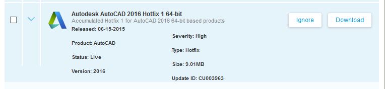

Regarding the general method of ditributing updates to machines, I have been managing updates via the Autodesk Account portal. This has an option to 'ignore' updates, which I believed would stop an update from being available to machines. This doesn't seem to be the case.
Could someone please explain the function of the 'ignore' button in the portal, or should I just ignore the ignore button and manage distribution of updates using access control?
