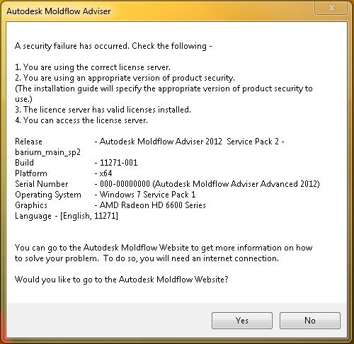

I can't run Autodesk Moldflow.I keep getting this error I've tried for weeks.
I started out installing Network License Manager on the server following the online youtube tutorial
I registered the serial and configured the host name and mac address on their website.
I created the license folder and copied the .lic file to the Network License Manager Program Files folder and configured all the options
I installed the Autodesk Moldflow Adviser 2012 on a workstation following the online guide and selecting the server.
It errored when I tried to run it. I tweaked some settings trying to get it to work but kept getting the same error.
When that didn't work I uninstalled the Nework Licensce Manager from the server and uninstalled Moldflow from the workstation I installed the Network License Manager on the workstation and reregistered the serial online with the new hostname and mac address.I copied the new key I got from the websited to the workstation and configured the license manager.Then I installed moldflow on the workstation entering its own hostname when prompted.
but I still get the same error.
Thanks for any help

Did you configure your license manager with the LIC file and confirm that it is working and showing your available license?  If so and if the NLM is on the same workstation as your application, then it is likely a IPv6 connectivity error.

I followed the IPV6 fix tutorial but I get the same error.
I attached the LMTOOLS logs
License server status: @tvdelop12h106.tvlsd.local     License file(s) on tvdelop12h106.tvlsd.local: C:\Program Files\Autodesk Network License Manager\License\MFAA2012enlicense.lic:
lmgrd is not running: License server machine is down or not responding.  See the system adminstrator about starting the license server system, or  make sure you're referring to the right host (see LM_LICENSE_FILE). Hostname:      tvdelop12h106.tvlsd.local License path:  @tvdelop12h106.tvlsd.local; FLEXnet Licensing error:-96,7.  System Error: 11001 "Comm. error" For further information, refer to the FLEXnet Licensing documentation, available at "www.flexerasoftware.com".

The LMGRD is failing to start because your LIC file is not matching what LMTOOLS expects.  Changes are either your LIC has a FQDN as the hostname or your system settings tab of LMTOOLS has the domain name box checked.  You do not need a FQDN to make your NLM work.  Check your LIC file.  If the hostname is tvdelop12h106.tvlsd.local in the .LIC, then check the domain name box in LMTOOLS system settings tab.  If not, uncheck the box.  You need these two names to match before the NLM will start successfully.

I modified the hostname in the license file rebooted and it worked
tvdelop12h106
Now I have to figure out how to run it on a limited account
but at least it runs

I did not get any error but only this
Security Failure
even i install AMI on the server, i had the same thing. I ping the ip and hostname is working ipV4. I did follow to disable the ipv6 by download and install microsoft fix ipv6 disable.

I installed Network License Manager and Autodesk Moldflow Adviser 2012 (student version) in my laptop computer following the Autodesk Moldflow Adviser Installation Guide that I downloaded it from the Autodesk web site.
I cannot run Autodesk Moldflow 2012 during the running it show SECURITY FAILURE window.
I created the license folder and copied the .lic file to the Network License Manager Program Files folder.
How can I resolve this issue? Please help me
