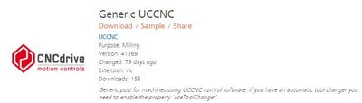

I'm using UCCNC and can't figure out why the drilling toolpath is generating incorrectly. It might be my mistake, but I would like to hear from You gents.
I double checked, and seems I have downloaded the latest UCCNC postprocess:
And this is what I getting when posting a drilling toolpath:
