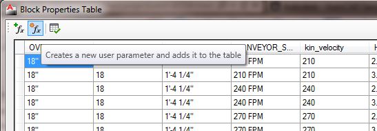

Greetings, boardmembers. Have I got a doozy of a problem here, and all kinds of help is appreciated.
I've been creating company-standard blocks lately. My latest skill is getting the Block Properties Table into my blocks, in order to automatically edit Block Attributes (i.e., making a Smoke Detector symbol's attribute to appear as SD). Got things working great so far....
Until I tried to save my blocks as separate files!
After creating my block(s) and placing them in a master DWG file model space, assuring that it works properly, I've gone back into the Block Editor in order to save it separately via the "Save Block Definition to Drawing File" toggle. Maybe not my first mistake, but my biggest mistake was having faith in this, and not checking my saved files sooner. So, when I did click on a block file that had a B.P.T. in it, opening the file opens in Block Editor. But, I am unable to pull up the B.P.T. in spite of the Table Grip being visible. Also, the affected attribute itself has been deleted. It is not even shown in the Parameter Manager. Needless to say, this whole situation is unacceptable.
Has anyone else dealt with this? How else can I save such a Dynamic Block with a B.P.T. as a separate file?

Here is what happens with me. I "Save As" my table-functioning block with the toggle on, so I create a new file. When I open the new file, I am instantly asked if I want to enter Block Editor (due to authoring elements). If I do not enter Block Editor, all I see is an ellipse (this may be the exploded state of the block, as you mention). If I do enter Block Editor, I see the grip for the BPT along with the ellipse. However, nothing happens when I try to see the BPT itself. And, the attribute that I had created before is totally gone, no matter which way I enter my new file.
Chris Martin
Message 10 of 18
in reply to: Charles_Shade
Mr. Shade,
I just put on my Sherlock Holmes hat, and this is what I found. So you know, my BPT had two columns. The first was a User Parameter, just to name the type of tag the ellipse was for. The second was for the value of the attribute that I needed.
First, I deleted the User Parameter column. When I "Save As" the block, the same problem happened.
Then, I deleted the Attribute Value column from my BPT. When I "Save As" the block this time, I have a file with the ellipse, the attribute, and the BPT. Of course, the table is useless because there is nothing to change from one value to the next. But, at least the BPT is there, and it can be opened and edited.
So, my inner detective deduces that there is some issue with my attribute that is causing me hell. Any ideas?

Make the Block in the BE as you have been.
Save Block As... WITHOUT the Save Block Definition to Drawing File checked.
Close the BE
Run WBLOCK and choose the Block you just named.
Now does it retain the BPT?
Message 16 of 18
Salvation!
It worked! It's quite a few kilobytes larger than the way I was saving blocks, but considering my way turned out to be a failure, compared to yours which was successful, I'll deal with it.

First, MVP blocks (using the Visibility Add Lisp to add multiple visibility parameters) does not officially support use of the Block Property Table (BPT). The author, Andre Lazebny pointed this out in his posts. However, though much trial and error I discovered that the sticking point between MVP and BPT is actually only the user parameter which is generated from within the table.Capture.JPG
If you place an EMPTY(no columns or rows or properties defined yet) BPT in a dyn block BEFORE you convert it into a MVP dyn block you can sucessfully create a block using both. you would create all your visibility parameters and define your states, and when everything else is defined, the last thing you would do is fill in the table using existing parameters and even defining user parameters. this would then lead us to the second trick which is pertainant to this thread...
