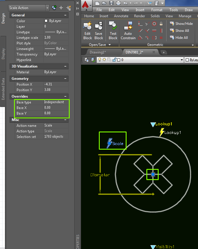

Of the attached block, a DIN7981 screw, my base point keeps moving further and further away from the base point when changing it's thickness. I think it has to do something with the scale action, i aint entirely sure though. The block is far from finished but this problem is already annoying me a lot..
Any idea's how to fix it?

in Your block scale action base point was not in correct place

Ojuris,
Many thanks! But how? I can't seem to find any difference between your drawing and mine..? I set the scale action base point to midpoint and set that to the center of the screw. What have you done to fix it?
-Patrick
ojuris
in reply to: pjr.remmen
You talking about   Linear parameter  (Diameter)
I talking about   Scale action (Scale)

I did not knew that... Many thanks!
