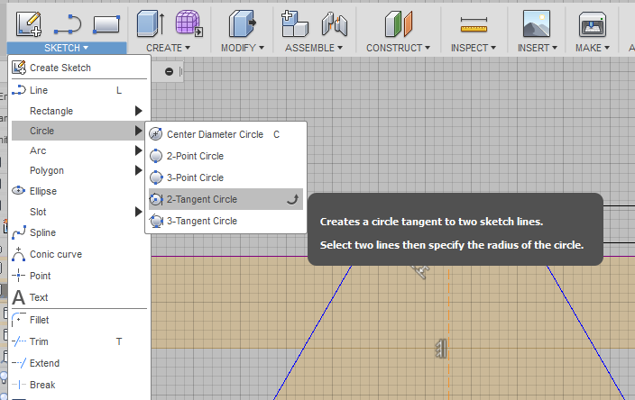

As workaround, we can create the fillet manually, firstly launch 2-tangent circle command:
Create two circles, and add dimension to one circle, add equal constraint to two circles:
Trim the circles and line segments:
Now we will get the fillets:
We will investigate the bug and try to find a fix. Sorry for the inconvenience!
