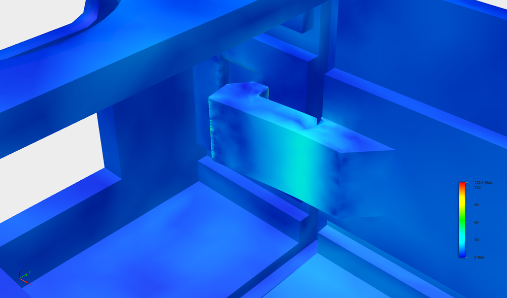

Thanks for the explanation Jeremy. Having element deletion enabled is the normal thing to do in this situation, right?
The value for "Maximum Elemental Principal Strain for Deletion" was at 0.01, and I re-ran it with 0.05 based on the tip above with better results.
I did fiddle with the material settings because I was trying to model the SLA printer resin I'm using (Formlabs "Clear" v2), based on their datasheet. It's possible that I got something wrong there, so I am currently re-running the simulation with a built-in material from Fusion 360's library (I picked "Acetal Resin, White" this time). That simulation is still running (each run takes about 1 hour) and I'll see if that material change, combined with the 0.05 value produces different results.
The change to 0.05 already changed the simulation result so that the snap fit lever no longer breaks off completely. However it's also not returning to the expected resting position at the end state because it still breaks a little bit on one side. The real-world material is more flexible and it deals with the amount of displacement of the lever just fine, but I'm not sure which value I have to change in the material configuration to get that into the model.
I'll see how the "Acetal Resin, White" material behaves.

I'm glad to hear the most recent solve is looking better. I suspect there must have been something about the material properties that you entered that weren't quite right. If you can give me more details about what you entered and where I can help you figure out what went wrong. If you also point me to the datasheet you're referring to I can give you some guidance on how to setup a nonlinear material model for the Formlabs resin.
For plastics in general I think a deletion criteria of 0.05 is definitely more reasonable than 0.01. If you had a cast resin or a molded plastic, a much higher deletion criteria would be suitable, but considering your part is 3D printed I suspect it will fail at a much lower strain (though this is just a guess).
More often than not when running an Event Simulation study you will want to enable element deletion. The times when I would recommend turning it off are when you're confident that your simulation will not result in a part of your model breaking. Because you're not entirely sure whether the buckle will break, and you ultimately want to pull the buckle apart until it breaks, then using element deletion is definitely the right thing to do for this model. What you've observed so far is certainly not a normal pattern of element deletion, which looks to be caused by bad material properties. I think you'll find that the results using the acetal resin material are going to look a lot better!
Jeremy Wiesner
