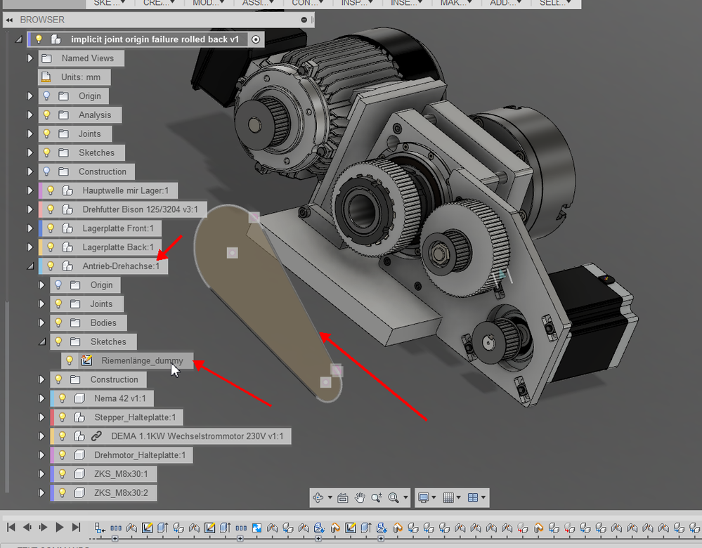

Also, I found some other strange behavior with your design. While investigating your timeline to try and figure out what exactly was causing the issue, I had rolled the timeline marker all the way to the beginning and was progressing through it, feature by feature until I hit the feature that caused the warning to appear. I noticed that it appeared shortly after you created the component "Zahnriemenrad_HTD_60_25_17246000 v2". It was at this point that I discovered that there was a "ghost" sketch appearing in your design as shown below. The strange part is that the sketch should be suppressed because it was created after the timeline marker. For this reason, I have logged a new bug (FUS-28132 for your reference) for our development team to review.

That "ghost image" is not a problem, really.  Component highlight in Fusion shows sketches owned by the component, even if they are hidden.  The weird part is that this is true even if the sketch does not yet exist (that is, if the history marker is rolled back before the sketch's creation).  You could argue that this is a bug, and we'll look into fixing it, but it does not indicate any sort of data corruption in this model, and seems unrelated to the implicit joint warning.  Here is a view of that sketch when it does come into existence:
If you are curious to see this behavior in a simpler model, check out this screencast:  http://autode.sk/2ftkTUD
Now, back to the original problem.  I continue to look into it, but have not tracked down the actual cause.  If you are correct, @macmanpb, that this is from a joint that no longer exists, then we do have a bug.
It's probably worth a little explanation of what these "implicit joint origin" things are.  When Fusion first was released, you had to create explicit Joint Origin features in order to create a Joint.  We realized that this was cumbersome.  But, we needed the joint origins in the data model.  So, now, when you create a Joint, we implicitly create joint origin objects for the geometry that you pick for the joint.  We do not show these in the browser or timeline, because you didn't create them yourself.  So, when one goes bad, it becomes a bit of a challenge to find these guys and fix them.
