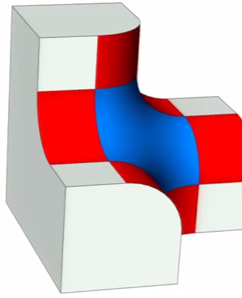

Im kinda not satisfied using the fusion 360 because sometimes i kinda frustrated like for example i want a 10 mm corner fillet but the software wont allow me. well in fact i can do it in other software. one of the most thing that frustrate me is that you cannot blend corners with different fillet value

This is what i want so that the intersection of all the fillet will blend.
see the difference between the screen shot i uploaded

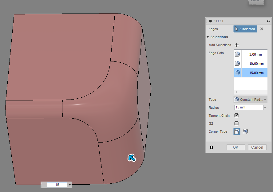

this is how i use fillet

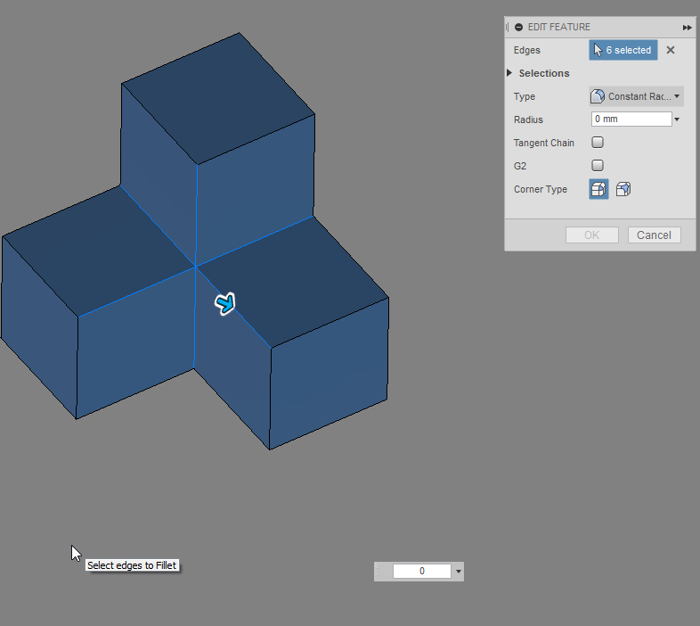

You need to select all the edges to fillet in one go. If you want to use Press\Pull hold the Ctrl key down to add to the selection or if you use the fillet tool just select all the edges before entering a size for the radius.
Select all edges while the fillet is set to zero.
That said the blend Fusion creates is not the same as your example, it adds a setback that you might not want.
It looks OK if you turn off the display of edges though.
I tested in another program and got the same as your sample so if this is something you need add a request to the Ideastation.
