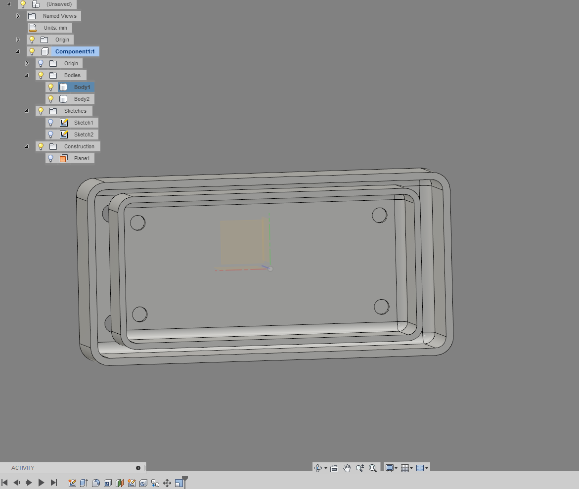

This brings up an interesting behavior that Mike and I were discussing a little while back.  With multiple component instances, there is no parent-child relationship among them, so as you said Jeff a change to one, changes them all.  However, in a copy-paste of a body, the pasted body is a child to the original, such that a change to the original will be reflected by the child(ren), provided the change(s) to the original occur in the timeline before the copy-paste events of the children (note some changes don't have timeline events, such as driving sketch changes or push/pull, so these types will always be reflected by all children).  Conversely, changes to any of the children are not reflected by other siblings or the parent/original.  We were talking about this in an idea post here:
http://forums.autodesk.com/t5/fusion-360-ideastation-request-a/mold-cavity-shrink-within-combine-com...
where one instance this behavior comes in handy, is making a copy of a mold that needs to be enlarged a little bit from the original.
Above, the original on the left was copied and pasted, then the pasted child was enlarged, and a hole was then added to the original, yet placed in timeline before the copy-paste.  Below Mike shows an enlarged copy of a part, that again has changes reflected in it from the original.
As to using these multiple parent-child linked bodies to make drawings, one method that appears to work pretty well is to do a soft delete/Remove of any bodies in a component that should not show up in a drawing.  Once the drawing is made, these bodies are returned via deleting Remove events in the timeline.
The versatility of Fusion is great!
Jesse
I haven't really tested in yet, but I'm guessing the new linked files/inheritances do the same as these dependent/linked bodies.  As an aside, the Removing of dependent/linked bodies to make drawings as I mentioned is not necessary, being that can move linked bodies to different components and it appears they remain linked.
Jesse
HughesTooling
Thanks Jesse,
My head was spinning a bit there with the bit about copies of bodies still being linked even if you move them to another component so I just did a little test. Seems to work really well, in this example by rolling the time line back to before the copy I was able to add the extrude cut across the base part then have it in the component with shrinkage after rolling the time line to the end again.
I think it's one of those things you need to plan ahead for and have both parts in a component so you can easily isolate the time line for just those parts.
